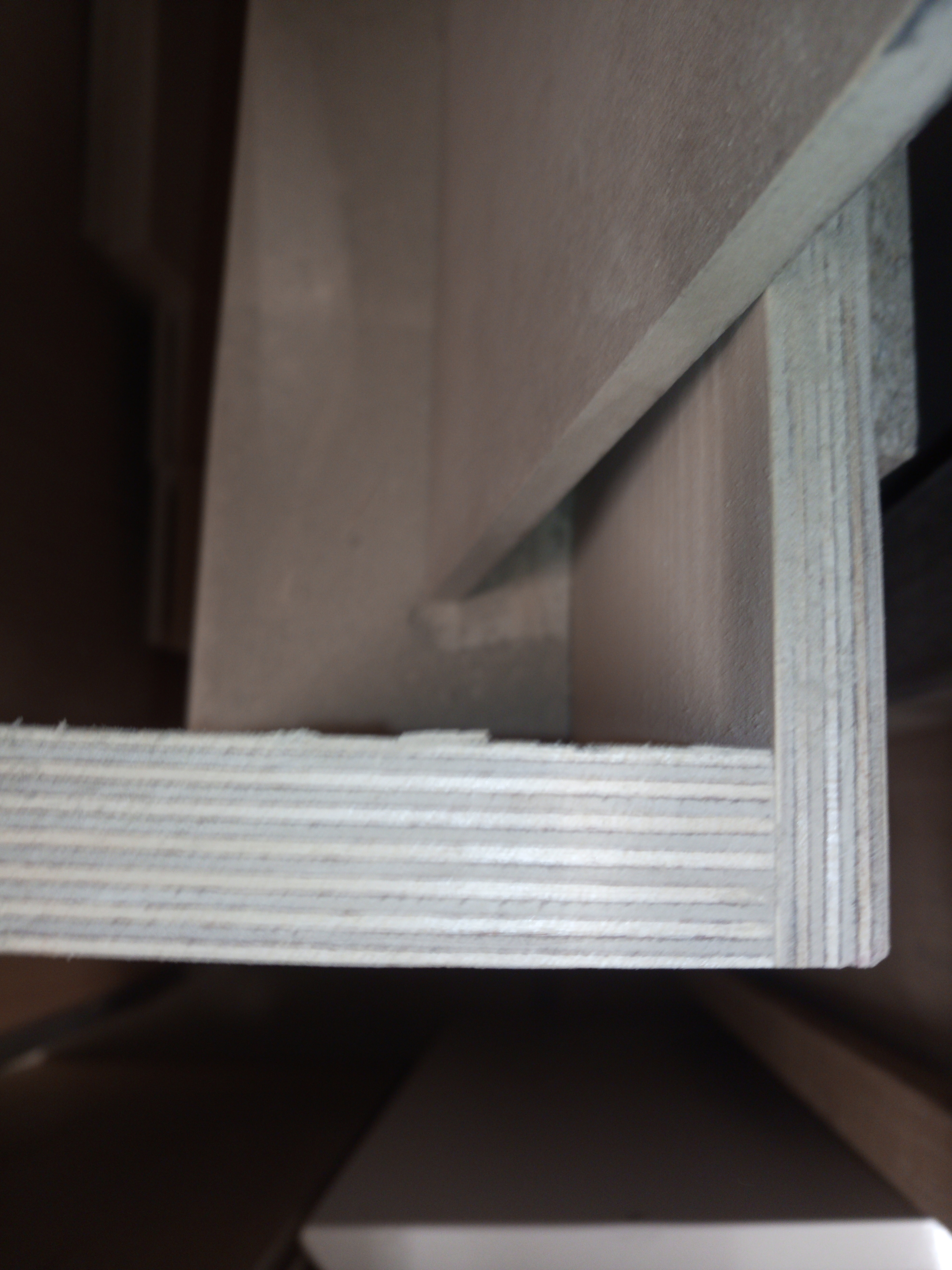

![IMG_20190320_134351|450x600]
Contrachapado normal
(upload://gJw0Zz18647HukgMFNbM6IeDKWu.jpeg) ![IMG_20190320_134247|450x600]
Contrachapado fenólico.
(upload://mPpJGQKJ2EDbc16aaBAGHFyTNzP.jpeg)
Contrachapado de abedul.
